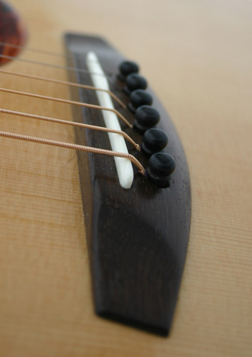

Sweet! The worst part for me is actually cutting the slot for the bridge...I tried the sliding cross vise ala John Mayes, but between my drill press and the cheapo vise, too much slop...I've gone back to the lam trimmer and jig...

I love that bridge...very nice, smooth lines, that's gorgeous. Say, what kind of bit are you using for that slot cut? Is this the same bit you use for your rosettes? Thanks.

Very Nice bridge
I love the smooth line look
PostPosted: Sat Jun 03, 2006 1:06 pm
   Stealthy indeed! Hesh, that bridge is drop dead gorgeous! Very elegant and tasteful. Hmmm, I just might have to 'borrow' that one off of you...
   I also share your design philosophy of trying to have it 'melt' into the top...

Hesh, that looks great. And I'm not just 'jerking' you around, either.

I'm gonna guess that at least the router base is from Stew-Mac. And my bridge routing jig from LMI looks totally different from yours. So...I'll go out on a limb and say that yours must have come from John Hall.
No wait, Stew-Mac. Looks good, and I like your use of it.

Nice looking bridge, Hesh. And glad to see the old avatar back, too. That one has "Hesh" written all over it.

Looks great Hesh!
Nice and subtle...but gorgeous

Beautiful design Hesh, i definitely gotta come up with my own now, gonna be lurking around and gather some ideas, yours and Alain's are truly great to look at.

Hesh, that is quite simply the nicest bridge shape I have ever seen. Nuff said.

I agree with Colin about both the the record and the bridge. Good job Hesh!
I use the same bits as you Hesh, but I like to use the lam trimmer instead of the Dremel, I think it is sturdier and gives cleaner results. I made a guitar with a bridge that looked almost like that a while back to, only in BRW (sorry about the lousy picture).

I like your bridge too...nice lines/curves. That jig is definitely a StewMac...I've got the same one. Now knowing that you have the jig why in the world would you slot the bridge prior to knowing your intonation marks. I always attach the bridge, intonate with the SM intonator, and then cut my slot.
p.s. enjoy the wood!
pps I too like using the lam trim rather than the dremel. The dremel is light, but a little too light and sloppy for this job...maybe I just have a bad one...Dave-SKG38872.7885069444

Very nice, Hesh. I dig it!
PostPosted: Sun Jun 04, 2006 1:31 pm
Nice job of contouring on your bridge, Hesh!
Regarding slot cutting: Without a plunging base, how do your start your cut? The "tip it in" method?

FWIW my method of slotting using a cross sliding vise and a drill press
the spiral bits worked HORRIBLE for me. I could not get a clean cut. I
then tried a cheap Ace hardware straight cut bit and it was like magic...
Now I have JOhn Watkins make them for me.. that's easier then all of
them..except on the pocketbook :)
